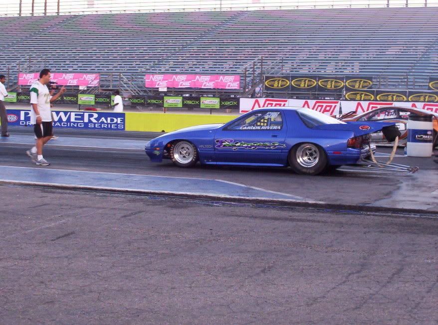

A very reputable shop talked with me about FI for the 350Z. They are well known esp for the RX-7's. They are known for the Japanese 3 rotors w/single turbos, and water injection. Aslo for their custom made turbo manifolds.
They tell me for a completey stock internal engine, with the high compression 5.5 lbs is safe for daily driving, but with some fuel tweaks you could run a tiny bit more boost. They are developing now a single turbo kit for the 350Z. And cost around 500 dollars cheaper than the greddy tt kit. They mentioned if you run 7+ lbs without less compression your really asking for it.
That car ran a [email protected] at Nopi in Ennis, Tx a few weeks ago.
What does your kit have or do that will allow someone to run 7lbs safely?
