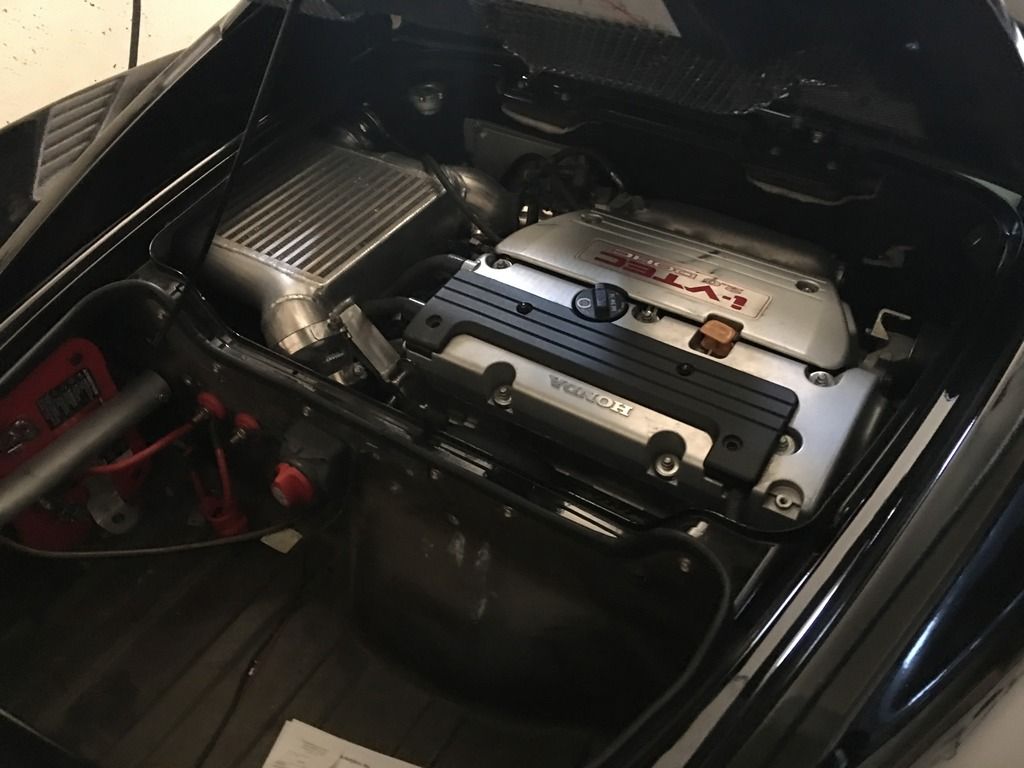

1,629 Posts
Discussion Starter · #117 ·
Found a set of enkei 18" RPF1s 10.5" wide 15mm offset. Everything fits, front gaps looks good rear gaps look wide. Wheel & tires came in at 44.5lbs each (call it 45lbs).
The TSWs were Front 57lbs / Rear 65lbs - a scary total of 244lbs. The RPF1s come in at 180lbs - weight savings of 64lbs...loving it.
Rounds 1 through 9 <505 lbs>
Approximate Vehicle Weight 3013lbs
Round 10
Lighter wheels <64lbs>
Internal brace +4lbs
Power Steering Pump/Lines/Cooler/Bracket/Fluid Delete -14lbs
total <74lbs>
Total Removed 579lbs
Approximate Vehicle Weight 2940lbs

Call this round 11 (and I don't know how this is gonna play out) swapping into true coilovers and replaced the OEM alternator with a 40amp/6lbs variant.
The power steering delete and downsized alternator will free up space to the turbo inlet - Greddy has an sass-backwards design with their filter to inlet ... where it goes from 2.75" > 2" > 2.75" > 3" ... so opening up that space will allow me to go to a 3" or a 4" filter to inlet duct.
The numbers:
Eibach Sportlines Rears(L&R) -16.4lbs
Tokico D-Spec Rears(L&R) -10.6lbs
Rear Seats(L&R) -2.5lbs
Eibach & Tokico Fronts(L&R) -30.2lbs (I cant/dont want to weigh these individually as they are bolted together)
OEM Spring Buckets -8.6lbs
OEM Alternator/Hardware/Bracket/Belt -16lbs
Total Deduction -84.3lbs
Lightweight Alternator/Heim Joint/Belt +6lbs
Traction Bars +5.5lbs
Coil Overs F & R +55lbs
Total Adds +66.5
Round 11 Net: 17lbs
Rounds 1 through 11: 596lbs
Total Weight: 2923lbs
