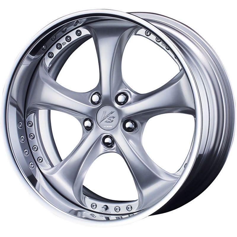

Hey guys, I really like these rims and considering purchasing them. I am really nub when it comes to cars, so I just have a few small questions:
1. Where I can get these from and for how much??
2. What size should I go for?? I was think 20".
3. I heard there is some issues up here in QLD and offsets of the wheels.. I dunno what offset means when it comes to wheels, but will i be able to install these wheels legally in QLD??
4. I notice, people buy a wider rim for the rear and a slightly narrower rim for the front, any reason for this??
5. Should I go for the lighter or darker rim to go with my paint colour??
Thanks guys I appreciate it!! :cheers:
Here is the website: http://www.worksuperwheels.com/wheels/vs_kf.html
Lighter Shade VSKF:
Darker Shade VSKF:

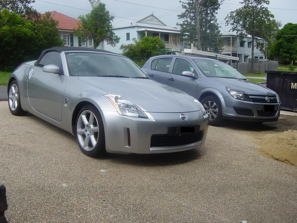

My current stock rims: :banghead:

I live in Qld and did a fair bit of research on the rules governing rim and tyre sizes before changing my wheels. In essence:
- You can increase track by up to 26mm for both front and back. This means that you can reduce offset by 13mm per rim. Standard offset for Touring or Track varies between +30 and +33 so you can take 13mm off these. Whatever, offset of most popular/quality rims (Volk, Buddy Club etc) tend to come in low to mid 20s which are, therefor, legal. I run F8.5X19" and R9.5X19" rims both with +22 offset which are legal in Qld and I have no problems with rubbing on brakes or guards (tyres F 245, R 275).
- You cannot increase offset by even 1mm (ie reduce track). In any case, it tucks the wheels inside the guards and does not look good.
- There are no restrictions on rim diameter whatsoever. The only control is that outside diameter of the tyre cannot vary by more than 15mm from standard. The tyre sizes that I use fall within this requirement. I havn't done the numbers for 20" wheels, but you would probably need to go to 30 profile tyres and be prepared to replace your rims on a fairly regular basis!!!
- Maximum increase in tyre tread is 1.3 times standard. In other words you can put tyres of up to 318.5 on the rear, but try getting those under the guards!
- Qld regs dictate that you can use only certain tyre sizes for certain rim widths. The spread in the range is fairly generous and should not present a problem either way.
The QLD Transport website is not the most friendly to use, but this info is there if you really want to fine tune what you are doing.
Congrats on choosing a great fun car and good luck with your rims.

So in a nutshell, in QLD your offsets (350z) MUST be between +33 (stock) and +20 so that you don't decrease your track or increse your track by more than 26mm. That is for the rear. If it ain't then it is illegal regardless of whether everything fits under the guards or not.
Offsets are the most important measurement when you are about to spend money on wheels. I find it difficult to accepts any vendor who do not publish their offset data.... absolute bullshit! You would think thay discovered some secret formula... it's not rocket science.
