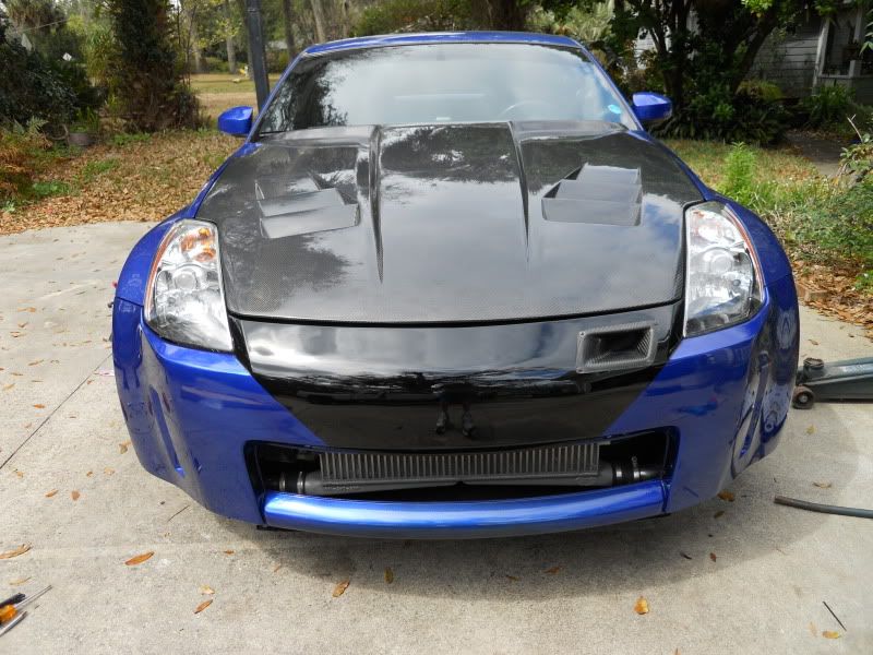

AIT-BMagic R1 Carbon hood... carbon quality seems to be very good actually, I was pleasantly surprised with it. Hood was noticeably lighter than stock, but not like, OMG THAT'S SO MUCH WEIGHT SAVINGS! Thus far, I give the carbon quality and the finish itself an A. It has molded spots for the strut bar, battery covers, etc, and fits over all them with no problem.
I'm not sure if this is "standard" but one thing I REALLY appreciate about this hood is that the latch is adjustable. This way, you can get the hood locked in nice and snug, as well as getting it to fit just perfect.
Got her out of those old clothes like a prom dress....
Hood on, and let me say for something that looks so simple (4 bolts), it was an ENORMOUS PITA. My dad and I put it on and took it off probably 7 times and made 2 trips to the hardware store to get new bolts and washers. The hard part was getting it centered (side to side). We also had to shim it up a little higher with washers because it sat below the fender line without them. We gave up on it last night because it got dark and finally finished it this morning. This is definitely a 2 person job, I couldn't imagine how big of a pain it would be to do alone. But, we DID get it, and fitment on this hood is quite good, I would say 95%, but not like 'OMG is that an OEM NISSAN HOOD?!' (more below). The holes match up absolutely perfect, thank God, and there is just probably 1/16-1/8 inch more room between the hood and the fenders.

So at this place on the hood on both sides, it fell below the fender lines and looked like sh*t.
Simple Fix. Ran down to the hardware store, again, grabbed a hard foam 3M pad, cut a little square, 3M taped it on (you probably wouldn't even notice it if you opened my hood...), AND...
Perfect fit.
So, in recap, after the huge PITA that was getting this hood installed and fit just right...well, it did just that, fit right. Coupled with the quality of the carbon, I'm gonna rate this hood A- overall. Looks, well, that's subjective. I love it, and I'm pretty sure anyone that sees it in person will love it too. If you don't like it, it would be difficult for me to express in words how little I care, so don't waste your time
My car sounded good before, but with this hood on, it sounds absolutely FIERCE!!! I don't know if it's the material, the vents, just that there's more room in there, or a combination of all 3, but in the cockpit, it sounds MEAN!! My mom noticed the difference right away (and that's really saying something) You can see heat waves coming out of the vents when driving, SOOO cool. The hood itself stays quite cool, but if you put your hand over a vent after driving, it feels like a space heater is going full blast on your hand.

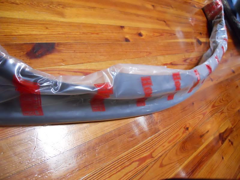

First piece I ordered some 3 weeks ago, last to get here. Came TODAY!
It is just the Intense Power front lip spoiler, but for only $179 SHIPPED, this is a REE-diculous deal. The urethane quality seems great, and it fit my car like a puzzle piece. I don't think it would come off if you did nothing but snap it on, but just in case I threw on some 3M tape and some bolts (pics to follow).
As I said, I am a HUGE urethane fan. With the scheme I went with (again, pics to follow), I think it looks right at home unpainted, which was the goal. This way, I can scrape it all over daily driving (bound to happen no matter how careful you are) without having to ever worry about cracking, paint chipping, etc, etc, and since the material itself is black, I am hoping it will just stay looking good...
